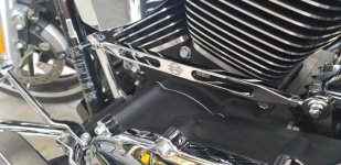

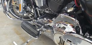

I have now officially replaced the heel and toe shift pegs, removed the bolts to the shift level arm and used locktite, and then snugged them down. And... While I was at it, this was a good excuse to basically deal with the whole system and get the fancy chrome shift linkage I've been wanting.
Here it is
I'll definitely keep an eye on everything...I hope it's not a problem by using the heel shifter, it's the first bike that I've had one on and I really dig it.
