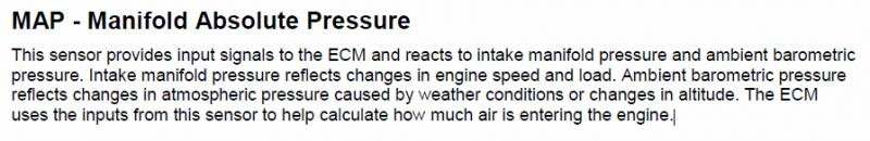

You do not need O2 sensors. The ECM should be using the MAP (Manifold Absolute Pressure) sensor.
From the TTS manual:
