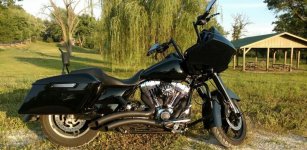

I also have a vivid black Street Glide and I opted for the blacked out look. Although it's on a pre-Rushmore batwing bike, the following photo will give you a little idea what it might look like if you went that route as well.
As for durability, my bike has been like this since 2011 (bought new in 2010) and I haven't had any issues with scratches or road debris marking it up.
Hope this helps!!
Lindsey :0)

Lindsey, sharp looking bike. I like the front wheel and head pipe. Is that a wrap?
