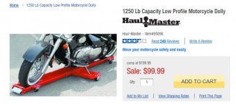

That already exists, but you did great. There are tons out there, Motorcycle dollies. My concern is always how hard are they to get off of.
Your ingenuity was great and it solved your issues - 2 thumbs up.
