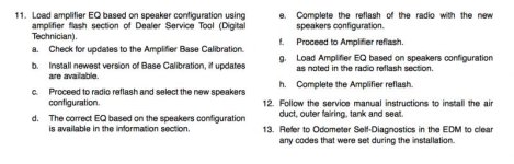

Installed mine over the weekend, I previously installed the upgraded speakers and the amp so the saddlebag lids and running the harness up to the radio was pretty easy. I will say that what a huge difference in sound! It was amazing at the difference. The rear speakers will not work until the dealer does his magic and unlocks them in the radio. When I dropped it off at the dealer for my dyno tune and radio software upgrade I made sure to tell him exactly what I wanted to make sure they do it and oddly enough when I came to pick it up the dealer said they had never done the things I asked for, thank goodness I printed out the part about flashing the radio, then flashing the amp, then flashing the amp again after installing the software upgrade. I have seen several dealer installs up there before so I don't know how they didn't know about all of it, they were just was unlocking the rear speakers in the radio software before I guess. Just print out that page of the instructions and make sure they do it.
