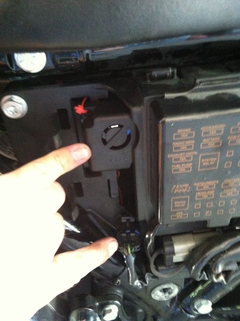

The reason I ask, is that I bought the system for my Rocker, and installed it myself......not as easy, since you have to remove the rear fender to get to the module.....but once installed, the bike wouldn't start. That's when I learned about the ECM reflash. So now I gotta push this thing up in to the trailer and haul it to the dealer for that....and I'm sure they'll try to gouge me on the price.
