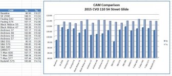

Found this over on the CVO forum.
All results run back to back on the same 2015 CVO street Glide (110 twin cooled motor). The bike was base-lined with a Fullsac DX Pipe and the 2" core replacements with the high flow AC with full tuning (TTS Mastertune used). All results are 5th gear SAE corrections.
