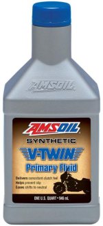

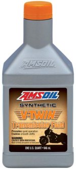

As an Amsoil user I don't use it in the chaincase but use the Bel Ry chaincase fluid instead.
Good to hear. I'm getting tired of hearing the noise. Next oil change I will be making a change. I've used belray and Amsoil for my dirt bikes. Maybe it time to try it.
I have been using Amsoil 20-50 in all three. I will try the new stuff in the tranny and primary at 10K this fall.
