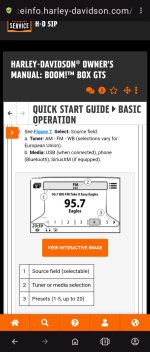

I take it that your SGS is equipped with the GTS radio. While listening to the radio, highlight the top bar and press enter with the right control stick. There you should find the option of AM, FM, Bluetooth, and/or XM.Screenshot_20240304_111450_Opera.jpg

I went into that screen and there is no bluetooth option listed, even though my phone is paired and shows so on another screen.
