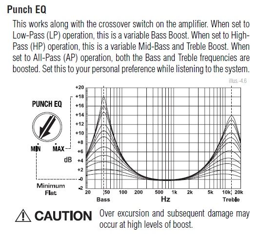

I have yet to experiment with the "EQ" setting on the amp, will do that soon. The sound is loud and clear from the front speakers only (I'm impressed). I have wires ran to the back of the bike under the seat, waiting for 6x9's in the bags. I feel there could be a touch more bass, but I know that's coming with 6x9's and EQ settings. Will add to this after more speakers are installed.
After some reading, I know why the sound is a bit "flat", needing more bass. I left the "EQ" all the way down in "AP (All Pass)" mode. Easy fix!
