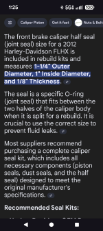

Anyone know the HD or aftermarket part number for this little goober? See the attached pic for details. I'd rather NOT buy a caliper o-ring overhaul kit just because this one rolled on to the shop floor and is nowhere to be found. Please advise. Mahalo!

Amelia--I grew tired of the online research and came up empty. So I simply used a DOT4 compatible o-ring from a kit that I had purchased earlier in the year. Both brakes and caliper are doing just fine, and I don't have a small drawer with excess caliper parts cluttering up my shop.
