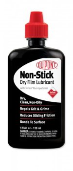

I found a clean dry lube that you can apply to the outside edge of the belt with a tinyl paint brush. Use the liquid, not the spray. Shake it up a lot.
Harley makes the front pulley so the belt tracks against the outside pulley flange.
I had a similar issue and this worked great. Do not run the belt loose, tension per the H-D manual.
I've seen this in black and white bottles: Dry Film Lube For Drive Belt Edge
View attachment DuP_InfoSheet_NON STICK_1511.pdf
