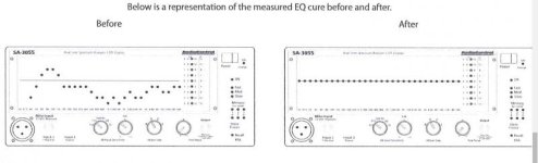

The goal of the flash for ANY aftermarket amp/system that doesn't have it's own way of dealing with HD's built-in DSP, is to get the flattest EQ curve on the output that is possible. view the pic below for BEFORE AND AFTER

Guess that is a result of the "flat" EQ everyone wants from the flash.

No... the flat EQ curve is what you want from the flash from DT... not the update via USB...
