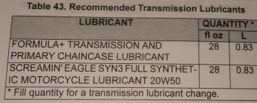

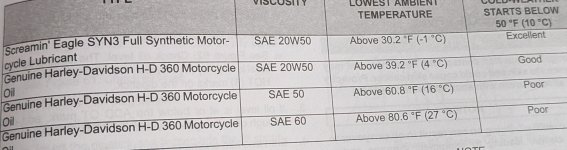

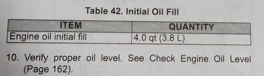

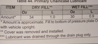

Good afternoon
Men and Women, just a question I want to change the oil of my M8 streetglide 2021. One talks about a kind of 20W-50 for engine and Transmission and Primary. And another about three different ones, it doesn't matter much for the money, but I want the best for the engine, the work is not it.

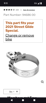

And which key do I need to unscrew my filter.
BvD. Peter :cool:
Good morning Peter, I have attached photos from my 21' touring service manual for you. These indicate the amounts of lubricants that you need. As far as the types that are needed, I just stick to what is recommended in the owners manual.
Also included is a screenshot of the oil filter wrench that I use.
