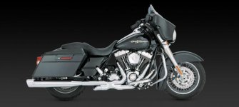

V&H Power Duals or Dresser Duals

From what I understand, 2-1-2 (V&H calls them power duals) provide better low end torque and are also a little quieter. True duals (V&H calls them dresser duals) are a little louder than the power duals and they say they have a little less performance in low end torque. I went with the S&S power tune dual header for around $430 from j&p cycle. Also check the Amazon price. The S&S looks like a true dual but is a great 2-1-2 system and I even think it looks better than the stock heat shields. I use the V&H 4" slash rounds slip-ons and I love my FP3. I would prefer it just a tad louder but being a little quieter can help you hear the audio better too. Bike runs amazing! If I didn't go with V&H muffs, I probably would have gone with Rienhearts...
