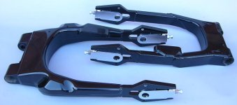

My buddy is a certified Harley technician and owns his own shop. He installed the 31T pulley for me when I was running the stock motor. In order to retain the stock belt he had to modify the stock swingarm (weld on small tabs, so that the axle adjuster cams would still allow for tightening the belt). When I decided to go with the 30T pulley, I wanted to stick with the stock belt which is 140T, vs switching to a 139T belt because I had read about lots of belt failures. This caused me to find a solution which would not only allow me to keep the stock belt, but give me flexibility if I ever wanted to play around with other gear combinations. The solution was have the stock swingarm modified 2" over with sport bike type adjusters. The stock belts are said to be the strongest on the market and should easily handle the power that the 110 SE Tire Shredder Kit puts out. Here are a few pics of the stock arm in its unmodified and modified form.
