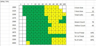

OK, so here is where I am now. Below you will see three maps. The first is from the ride I just did after applying the last learned information. The second is a side by side comparison of the first ride and the second ride. Both maps were "blank" visually upon the start. The blue cells are the new data. They still reflect yellow or green by letter. The summary between the two rides is 34 new yellow cells and 6 new green cells. the 6 green cells were not new per se. They were yellow and are now green. The third map shows where I am now.
My question is this. If I have a yellow cell now and I apply the learned information, do I need to relearn that cell before it turns green or will it go to green the next time that cell is logged? Is it truly better to keep applying or wait for more green?
Yellow is unlearned, but has some data... so it will use the applied data to keep learning from
The key is to target those areas of yellow by changing up your rpms and throttle to ride in those areas to make it learn... there is no set number of times to hit a specific cell like the Power Vision does... when it learns, it turns green.... that's it... could be 3 times.. could be 23... who knows.

Well I rode Skyline Drive yesterday. What a beautiful day! I am going to post four pictures of my spreadsheet.
1. I started my ride yesterday (285 miles) with a blank grid. I had applied after my last ride.
2. This is the map cumulatively speaking. It is the culmination of three rides and applies.
3. This is the side by side of each mapped ride.
4. I took an excerpt from the cumulative map and showed only the area in which I feel I ride.
My gut feeling is to finish, not apply, for now and see how it goes. As I understand from reading, this map that will be finished is better than where I started and I can always go back and autotune more.
Any comments/suggestions are much appreciated.
